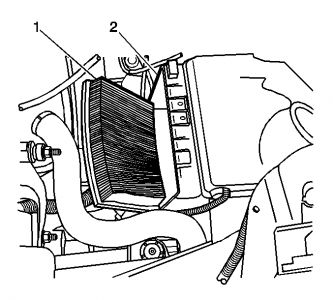

HOW DO I CHANGE THE AIR FILTER IN MY BUICK RENDEVOUS

Air Cleaner Element Replacement Removal Procedure Remove the air cleaner intake duct. Refer to Air Cleaner Inlet Duct Replacement Remove the filter element (1) from the air cleaner housing (2). Installation Procedure Install the filter element (1) into the air cleaner housing. Install the air cleaner intake duct.
