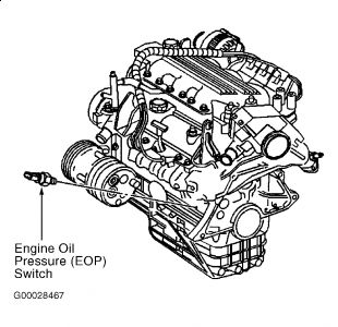

I have an oil leak under the manifold, above the starter on my Rendezvous, and I was wondering what part is located in that area, that could be leaking that needs to be replaced. Any and all help would be helpful, my husband is on SSD, and that is our only income right now so we hopefully can repair this ourselves.

Oil pressure switch does it have a wire

Yes it has a wire on it.

Thank you very much for your help and Time on this matter that was the part, it is changed and working now, I will tell all of our friends and family to visit your site for any help they need when it comes to their autos, I will also put it on myspace, and let all know, where to go for help when they need it. Thanks again!!
