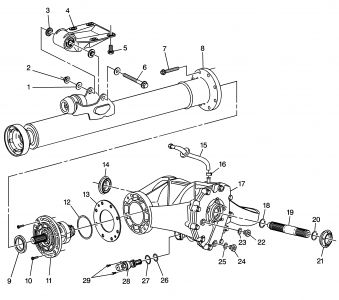

I have seen the statement - noise in differential - change oil with GM #.........
I have the oil
I have the car
I can't find the plugs
I have worked on cars for over 40 yrs - but I can't find the drain or fill port on the Rendezvous AWL Differential - any pictures or specific hole locations woiuld be appreciated.

https://images.2carpros.com/forum/automotive_pictures/102900_diff_1.jpg
(1) Washer (2) Nut (3) Spacer (4) Bracket (5) Bolt (6) Bolt (7) Bolt (8) Torque Tube Assembly (9) Oil Seal (10) Bolt (11) Pinion and Housing Assembly (12) O-Ring (13) Shim (14) Oil Seal (Right) (15) Vent Hose Assembly (16) Clamp (17) Differential Assembly (18) Snap Ring (19) Axle Shaft (20) Snap Ring (21) Oil Seal (Left) (22) Fill Plug (23) Gasket (24) Drain Plug (25) Gasket (26) O-Ring (27) O-Ring (28) Clutch Pump Check Valve (29) Bolts
