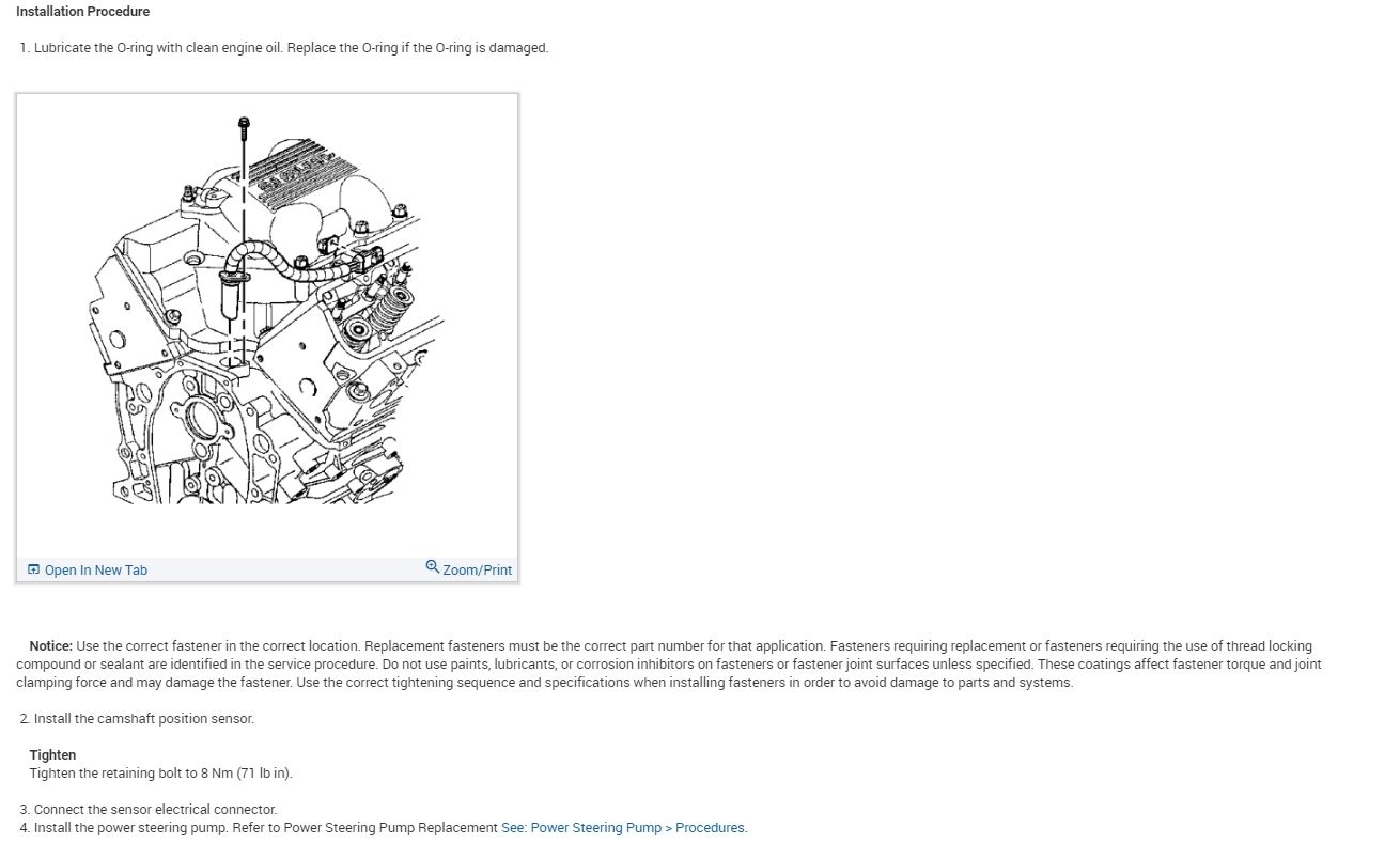

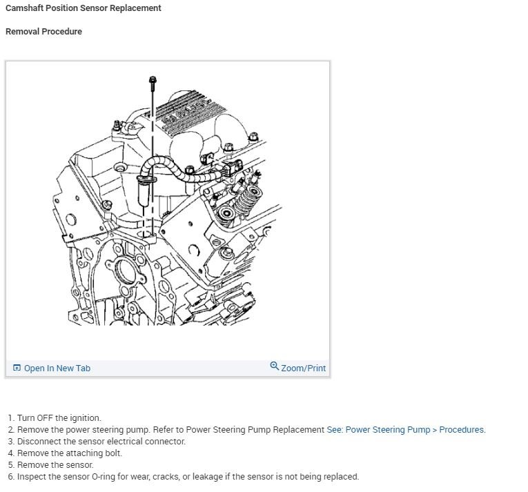

If cam sensor is bad it will not start. The cam sensor controls injector pulse, which is what lets fuel into the engine. Sometimes when electronics fail they do it when warm/hot due to expansion which creates loss of connection internally. You should have it scanned for codes to see what errors the computer has stored.
See the guides below. Scanning and cam sensor replacement. Not vehicle specific but will give you an idea of what is going on.
https://www.2carpros.com/articles/camshaft-angle-sensor-replacement
See the diagrams below for make/model specific instructions and pictures.
