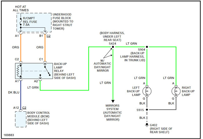

i don't have any back=up light i can't find a fuse for the back up lights nor do i know where the back up switch is on the transaxle any ideas
Jan 16, 2010 at 7:35 AM
  • 75,992 POSTS

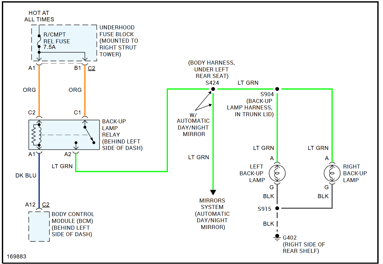

Check fuse R/CMPT REL 7.5 amp in under hood fuse block mounted to right strut tower and back-up lamp relay is behind left side of dash. Check out the images (below). Please let us know what happens.
