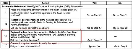

ON my 2002 Buick Regal, the high beam lights are not working. The switch on the left side of the dashboard is not working when I pull it out dosen,t do noting,but when i turn it the dimmer works. Low beams work and turn on. When I pull the switch turn signal on the stering colom towards me, the high beams turn on, but they DON'T STAY ON. What is the problem?It could be fuse for high beam? Please help.

https://images.2carpros.com/forum/automotive_pictures/55316_02regalheadlamp_1.jpg
