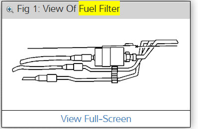

Can you please tell me exactly where the fuel filter is located? THANKS

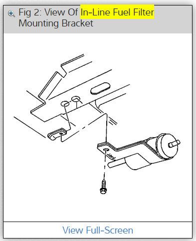

Under vehicle, driver side, below seating area, front of fuel tank, mounted on chassis in fuel line here is a guide that will walk you through the service

The fuel filter is located under the car on the left side near the fuel tank here is a guide and diagrams below to help you get the filter changed out.

check near the fuel tank or along the fuel rail. Fuel filters should be replaced aprox every 30K. You can check fuel pump pressure before and after the filter to know if it is plugged.
