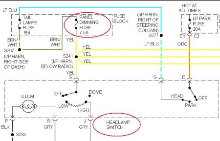

The panel does not light up so at night you can't see the panel while driving. THe light does not come on at all. I check all the fuses on the side panel.

If none of the lights one, you need to check your panel dimmer fuse. If that is good, suspect the headlamp switch.
https://www.2carpros.com/forum/automotive_pictures/55316_99regalpanel_2.jpg
