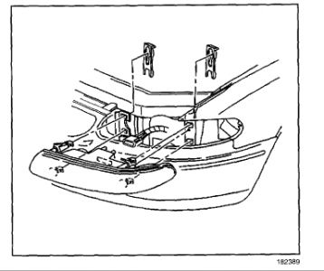

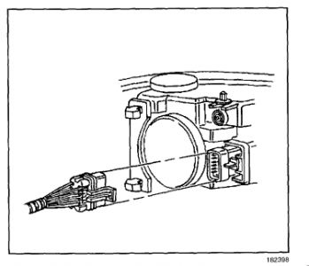

I am trying to replace a turn signal bulb on the front passenger side. My question is how do I remove the housing without breaking it to replace the turning signal bulb located in the inside of the lights housing? Your response will be greatly appreciated and I will have more question and donation in the future with repair question because I just receive some tools. Thanks
Nov 7, 2008 at 3:05 AM
IMPALASS
  • 3,112 POSTS

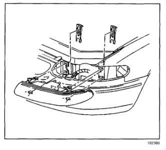

Hello I have provided the info your requested. Headlamp Assembly or Headlamp Bulb and/or Cornering, Sidemarker, Park, Turn Signal Bulb Replacement REMOVAL PROCEDURE
https://images.2carpros.com/forum/automotive_pictures/248015_1_40.jpg
Open the hood. Apply light pressure to the headlamp lens to hold the headlamp in place while removing the retainers. Lift up the headlamp retainers to release, then remove the retainers. Remove the headlamp mounting tabs from the slots in the upper fascia support and the fender reinforcement.
https://images.2carpros.com/forum/automotive_pictures/248015_2_27.jpg

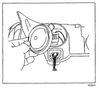

Disconnect the electrical connector from the headlamp. Remove the headlamp.

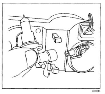

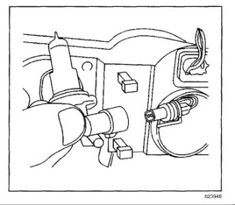

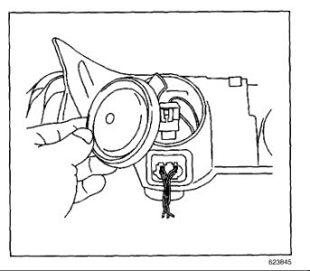

Remove the rubber access covers from behind the headlamp bulb/sockets to be replaced. CAUTION: Refer to Halogen Bulb Caution in Service Precautions.
https://images.2carpros.com/forum/automotive_pictures/248015_4_12.jpg

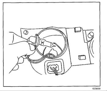

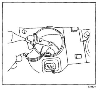

Rotate the headlamp bulb/socket counterclockwise to release. Remove the headlamp bulb/socket from the headlamp.
https://images.2carpros.com/forum/automotive_pictures/248015_5_8.jpg

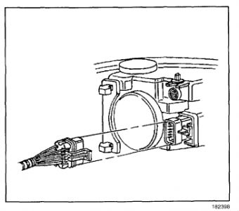

Disconnect the electrical connector from the headlamp bulb/socket. INSTALLATION PROCEDURE
https://images.2carpros.com/forum/automotive_pictures/248015_6_4.jpg
Connect the electrical connector to the headlamp bulb/socket.
https://images.2carpros.com/forum/automotive_pictures/248015_7_5.jpg
Install the headlamp bulb/socket to the headlamp. Rotate the headlamp bulb/socket clockwise until fully seated.
https://images.2carpros.com/forum/automotive_pictures/248015_8_3.jpg
Install the rubber access covers to the headlamp.
https://images.2carpros.com/forum/automotive_pictures/248015_9_2.jpg
Connect the electrical connector to the headlamp.
https://images.2carpros.com/forum/automotive_pictures/248015_10_2.jpg
Position the headlamp mounting tabs to the slots in the upper fascia support and the fender reinforcement. Apply light pressure to the headlamp lens to hold the headlamp in place while installing the retainers. Align the headlamp retainers over the headlamp mounting tabs, then press the retainers down until fully seated. Inspect the headlamp for proper fit. Check the headlamp aim, if a new headlamp was installed, or if service or repairs in the front end area may have disturbed the headlamp mounting brackets. Refer to Headlamp Aiming. Close the hood.
