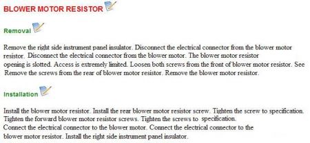

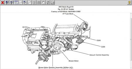

I want to know how to replace the blower motor resistor under the dash or glovebox area of my car.
Jul 24, 2009 at 7:46 AM
Experienced Mechanic
75,988 POSTS
Unplug it and then remove the resistor
