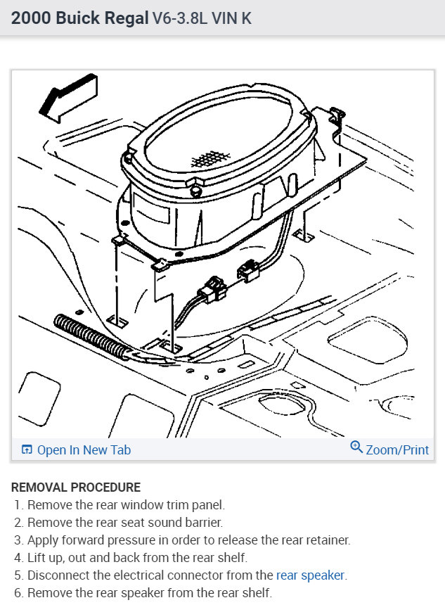

I purchased a pair of Monsoon 6x9 speakers and thought they could be replaced from the trunk compartment. The rear seat backs fold down, but I still can't figure out how to get to the speakers Can you help?

I just did this on my daughters car. You have to remove the 4 screws that hold the latch bracket that runs along the back of the seat for the rear fold down seats, then take out the rear deck cover by removing the 3 black plastic trim fasteners that are behind the seat bracket. Make sure you disconnect the brake light connector before taking it out of the car. Each speaker has 4 screw, torx heads, and has a connector to unplug and remove from the speaker. Check out the diagrams (Below). Please let us know if you need anything else to get the problem fixed.
