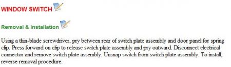

How do I remove the combination power windo and mirror switch from the drivers door?
