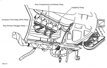

THE DAY TIME DRIVING HEAD LITES WENT OUT IVE CHECKED LAMPS FUSES CONNECTION TO BOTH SIDES OF THE LITES ALSO THE HIGH BEAMS ONLY COME ON WHEN I HOLD THE LEVER BACK MANUALLY AND THE SWITCH ON THE DASH WILL ONLY TURN ON THE PARKING LITES FRONT AND REAR I CAN HEAR A CLICK BEHIND THE GLOVE BOX ONLY WHEN THE SWITCH IS BEING PULLED OUT TO TURN ON THE LITES I REMOVED THE THE GLOVE BOX AND FOUND A SERIES OF 4 RELAYS ONE RELAY CLICKS WHEN PULLING OUT THE SWITCH STILL NO HEAD LITES

I would start by changing that relay. It is the headlight relay. Here is a picture of it so I know we are talking about the same thing. It is the one on the right. NOTE: Check the part numbers on the other relays. If one is the same, switch them to see if it helps.
https://images.2carpros.com/forum/automotive_pictures/249084_light_3.jpg
Let me know if this helps, and thanks for using 2carpros.com. Joe
