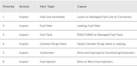

What is the most probable cause for a gas smell inside the car?

https://images.2carpros.com/forum/automotive_pictures/307763_Noname_20.jpg
