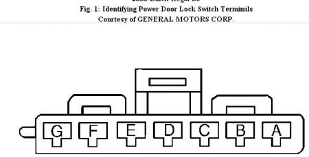

The right front door no longer locks. But I can still lock all the doors with the lock button.

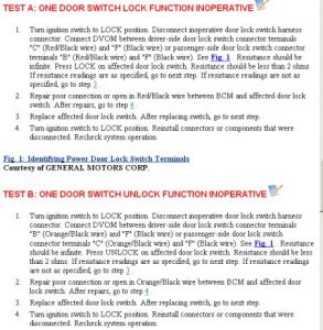

Probably a switch or actuator problem. This is the test for the switch:
https://images.2carpros.com/forum/automotive_pictures/30961_11lock_1.jpg
https://images.2carpros.com/forum/automotive_pictures/30961_11locka_1.jpg
When you say the lock button operates the lock, do you mean the key FOB?

yes, the door button and the fob will lock all the doors except the right front. The key also does not lock the door.
