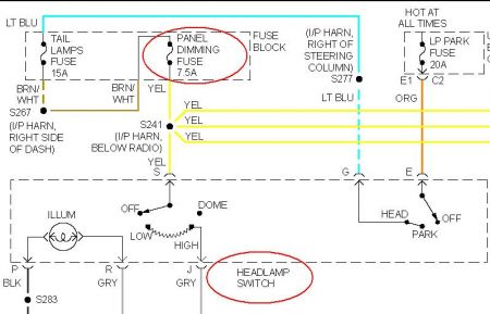

dash/radio/climate control lights go to the lowest dim settings when the headlights automatically go on at night. when the headlights turn off however. the dash/radio/control module lights work great and the dimmer control can work as normal. what can do to fix the lighting problem and whats causing it?

https://images.2carpros.com/forum/automotive_pictures/55316_99regalpanel_1.jpg
Try check the fuse panel for the panel dimming fuse. If the fuse is good, then your headlight switch is faulty.
