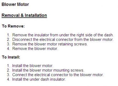

For the past 2 months the blower squeals when I turn it on, so, I have to immediately turn it off. It does this regardless of the speed I set it on.. As a result I did not have sufficient heat in the car. Will I need a new blower or do you think this problem can be solved? Thanks for a reply!!! Adda M. Gontarz
I may be an 84 year old female but I am still capable of doing lots of minor repairs to my car---- I feel this is one repair I may need some help with. Thanks again!!!

Hi Adda, you probably need a new blower motor.

Thanks so much for the prompt answer!! Well, your directions for removal do not sound too complicated. As soon as I have a decent weatherwise day I will give it a try. Will need it working when it is time to run the AC.
