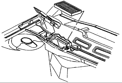

wHERE IS THE CABIN FILTER IN THIS CAR AND HOW DO I REPLACE IT WITH NEW FILTER

i BOUGHT A ERVICE MANUAL AND NEITHER THAT OR THE BUICK MANUAL GIVE ME THE INFORMATION

Remove or Disconnect : Turn off ignition switch when the windshield wipers are in the up position. Raise hood. Windshield washer pump hose from fender rail and cowl screen. Reposition hood weather-strip from right side of vehicle (peel back half way to center). Air inlet grill retainers. Air inlet grill. Passenger compartment air filter. Install or Connect: Passenger compartment air filter. Air inlet grill. Air inlet grill retainers. Mood weather-strip in place. Windshield washer pump hose to fender rail, and cowl screen. Close hood. Return windshield wipers to park position. Here you go.
