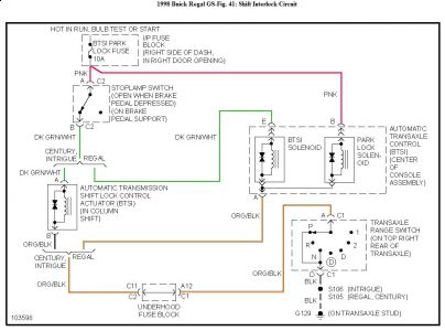

With the engien running and foot on brake will not release from park when I push down on the shifter button there is a clicking noise under dash

There are 2 solenoids under the center console and one of them is not working.
I would suspect the Park Lock solenoid as the brake induces a clicking noise which should be from the BTSI solenoid. However you would need to check if the solenoid is moving sufficiently to release the lock.
https://www.2carpros.com/forum/automotive_pictures/192750_ShiftInterlock98RegalFig41_1.jpg
