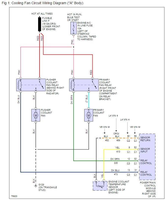

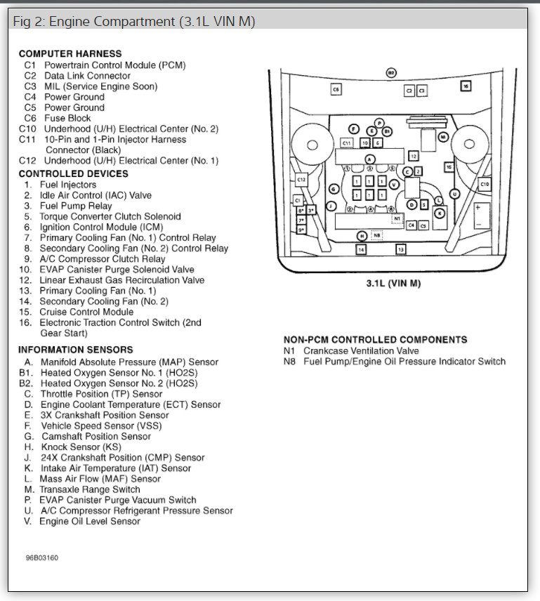

I have a 1996 Buick Regal Grand Sport. I am trying to replace the coolant fan relay switch (5 pins) and I just cannot seem to locate where it goes! Any help would be greatly appreciated!

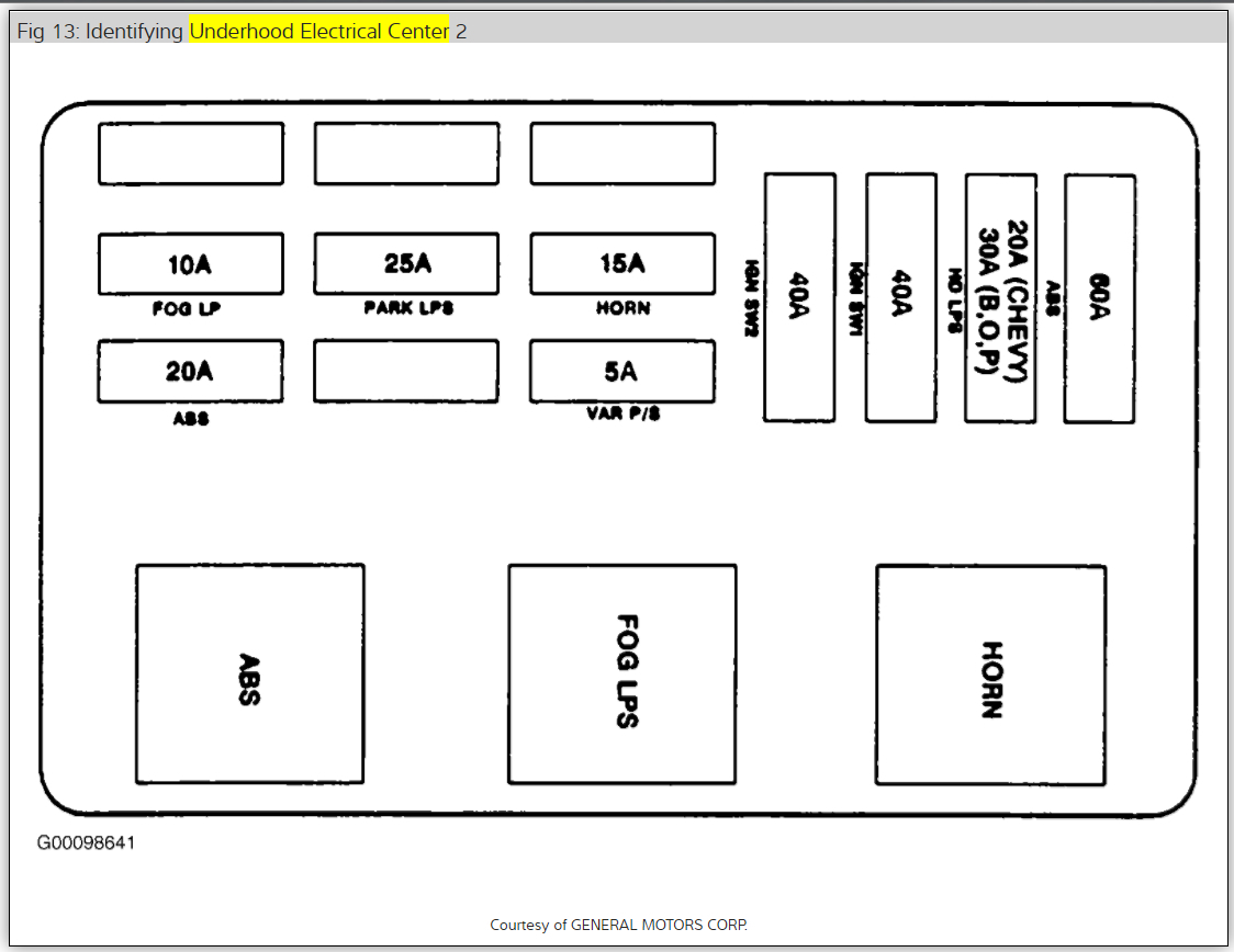

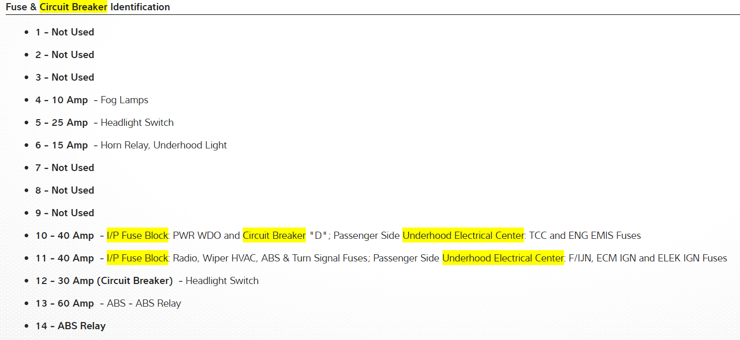

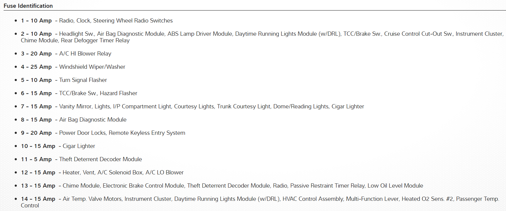

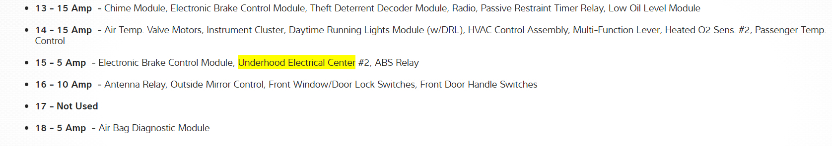

Here is a guide and diagrams to help you find the relay and coolant sensor for the engine which triggers the fans to work.

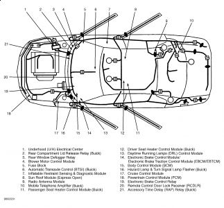

1998 Buick Regal V8 Front Wheel Drive Automatic 115000 miles

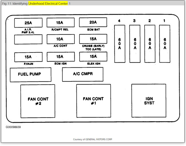

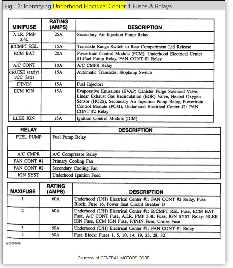

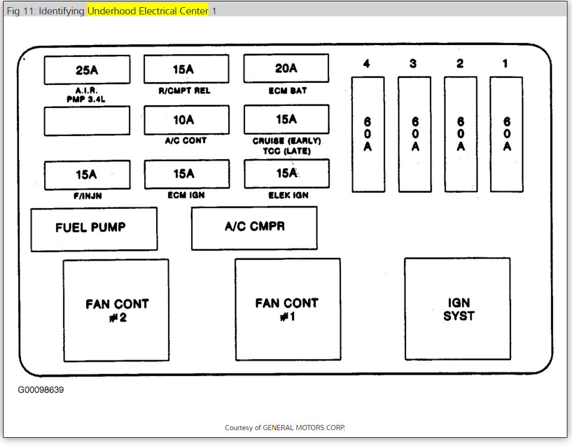

Used the diagnostic machine to check why the check engine light was on it shot out code P1651 which is the Fan 1 control circuit relay. Where is it located and how do I change it?
Dec 31, 2017 at 7:25 AM (Merged)
BLUELIGHTNIN6
  • 16,542 POSTS
Cooling fan motor relay number 1 isl ocated in the underhood electrical center, pictured below..
https://images.2carpros.com/forum/automotive_pictures/261618_1_45.jpg
Simply pull out relay, much like removing a fuse, then replace with new relay. Thanks for using 2CarPros.com!
