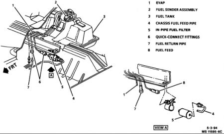

Fuel filter location
1995 BUICK REGAL
TBOP75
Six cylinder front wheel drive automatic 188,000 miles. Where is the fuel filter located at on a 3.8L engine?
Jan 25, 2010 at 11:34 PM
  • 75,992 POSTS
The filter is located on the drivers side rear cross member just forward of the fuel tank.
https://images.2carpros.com/forum/automotive_pictures/12900_fuelfilter_1.jpg
