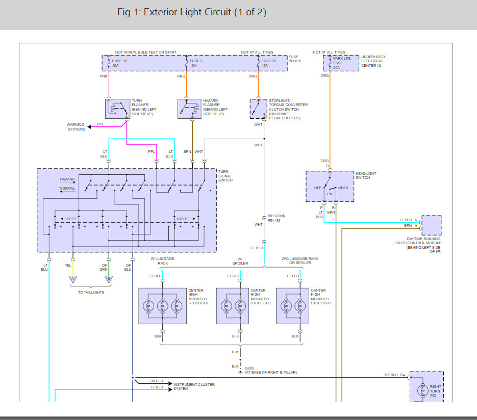

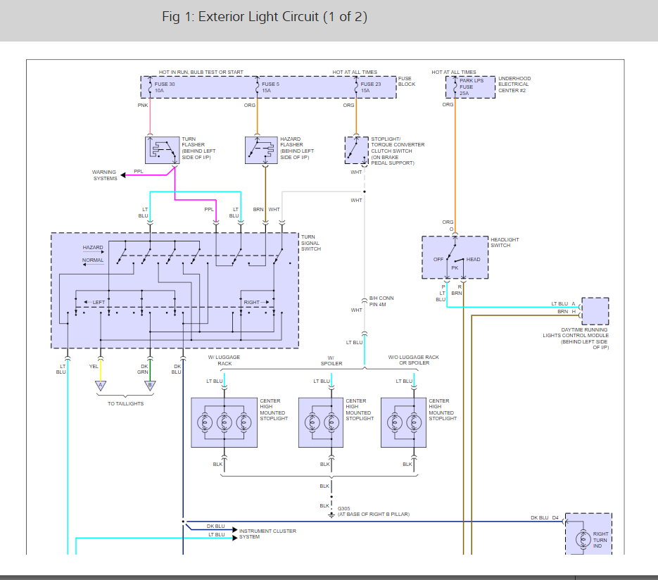

ok, i have a buick regal custom (1995) and i was told my brake lights were out, i replaced the lights themselves and adjusted the brake light switch under the dash, they worked for almost 3 days then went out again i looked at the fuses all were good except for the cig lighter fuse..lol..which i replaced.
we checked the continuity on the switch and the switch plugs and the bulbs and the bulb plugs all looks to be ok, but still no brake lights...can ya help me on this?

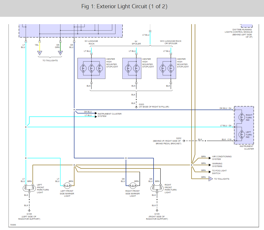

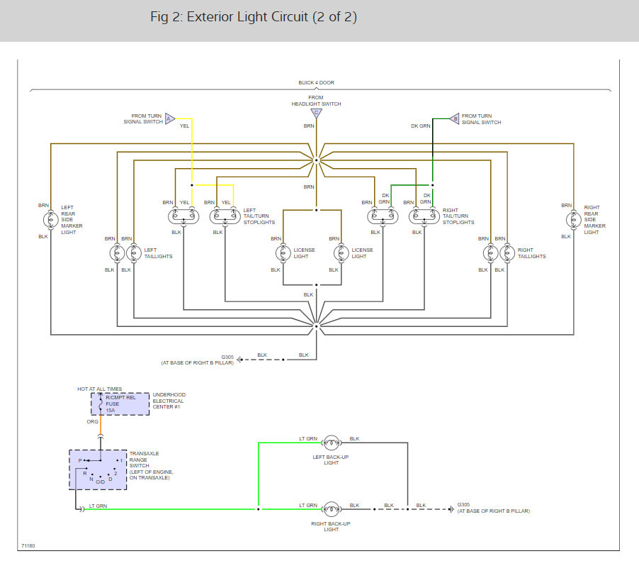

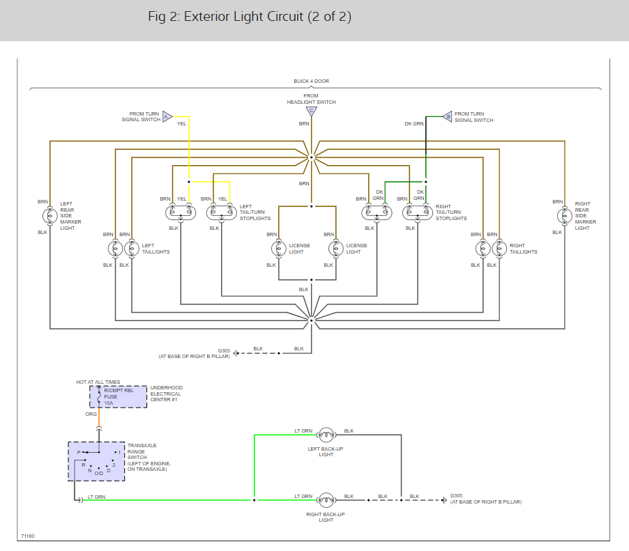

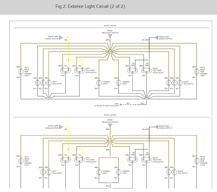

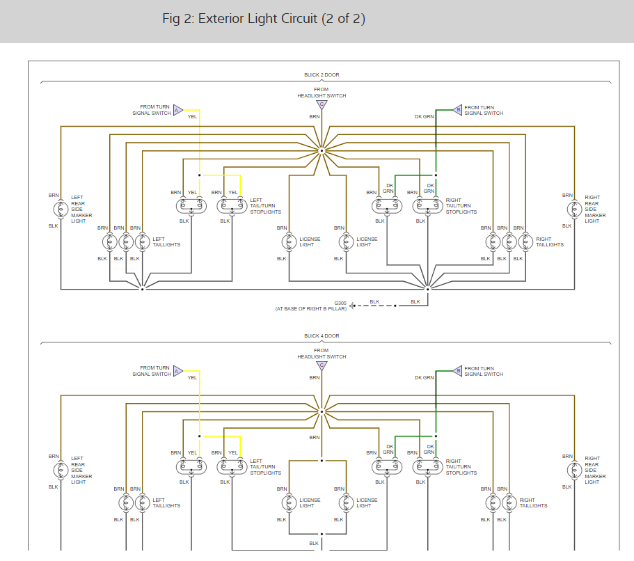

Here are the brake light wiring diagrams and a guide to help us see what's going on:
https://www.2carpros.com/articles/brake-lights-not-working
See how the brake lights work below. Check out the diagrams (below). Please let us know what you find. We are interested to see what it is.
