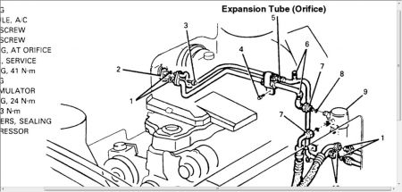

The orifice tube is not where the manual says it should be and I believe we have checked everywhere. any suggestions. Sorry unemployed for 2 years. Can not make a donation or I would

There you go and have nice day
https://images.2carpros.com/forum/automotive_pictures/12900_orifice_1.jpg

the orifice tube is located in the end of the liquid line closest to condenser
