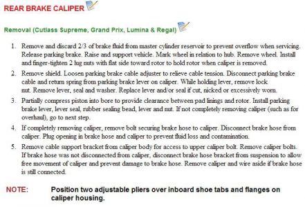

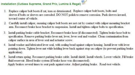

I want to change my rear brake rotors myself. I wante step by step procedure on how to do this.
