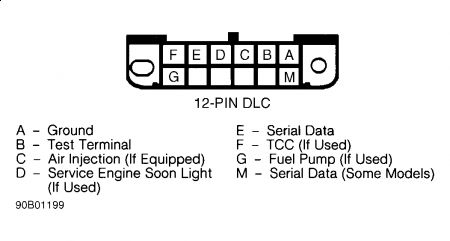

Hi Probably shift solenoid lets see if ECM can tell us what's up. Locate ALDL on lower dash near collumn see diagram. Jumper between term. A & B paper clip works. KEY OFF then turn key on not to start. Check engine light will flash if codes present. Flash pause flash flash = 12. Post codes Let me know Thanks for
https://images.2carpros.com/forum/automotive_pictures/198357_Graphic_22.jpg
