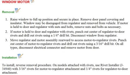

How do you install a power window motor on a 92 buick regal?

https://images.2carpros.com/forum/automotive_pictures/261618_Noname_2501.jpg
