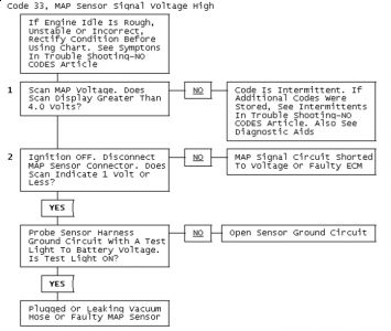

Hello.
How to fix a DTC-33 MAP sensor error ?

Hello and thanks for donating Follow the troubleshooting tree below to pinpoint the cause of this trouble code.
https://images.2carpros.com/forum/automotive_pictures/261618_Noname_1977.jpg

It was just a broken depression hose.
Thanks for your help
