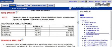

HOW MUCH FLUID DOES MY TRANS HOLD WITH A NEW FILTER-1987 BUICK GRAND NATIONAL, #409 AUTOMATIC ???
Nov 16, 2009 at 11:55 AM
Experienced Mechanic
75,988 POSTS
See below
