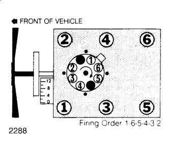

recently i had my friend tune up my car. Being the retard he is he mixed up the cords and now i have no idea how to put them back. I have the firing order but i have no idea which plug is which. So the firing order is no good to me. Any help you can give me would be greatly appricated. If possible something with pictures so a car dummy like me can figure this out. yanmk you kindly.

If 3.8 L
https://images.2carpros.com/forum/automotive_pictures/198357_Graphic_419.jpg
