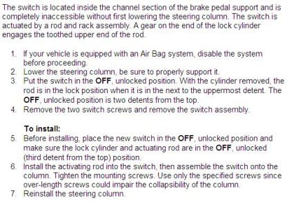

1985 Buick Regal V8 Two Wheel Drive Automatic
howdo i change the ignition switch on a 1985 buick regal ?

Welcome to the site.
https://images.2carpros.com/forum/automotive_pictures/170934_regal_ignition_switch_1.jpg
