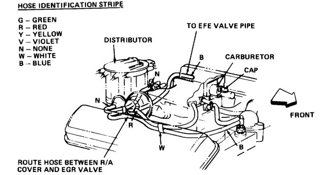

Hello, I am an owner of 1979 Buick Regal Ltd. I recently took all parts off of the engine down to the block to strip it and re-paint it. Well all of that is done now and I have about 85% of everything back together. The problem I am having is where to put all the small vacuum hoses, I know where some of them are but I need a true diagram and cannot find one for the life of me. Please let me know where I can find one or if there is any database that can help me. Thank You.

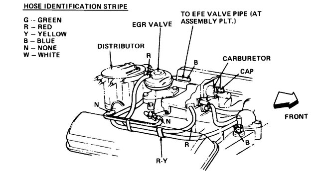

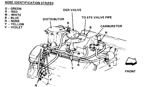

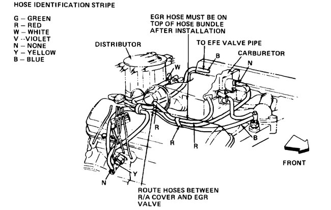

Here are the vacuum lines for the engine and emissions systems there are different options which I have included you will need to check to see which ones you need. Check out the images (Below). Please let us know if you need anything else to get the problem fixed.
