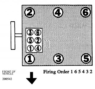

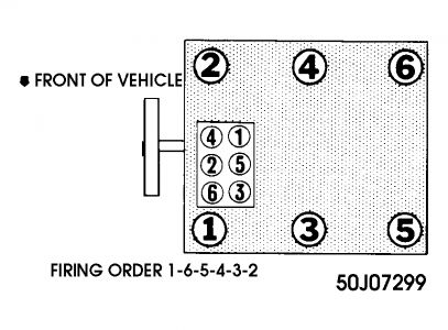

I just replaced my rear spark plugs on my Reatta. I did the front ones a little while ago and it was no problem. Now that I did the back ones, im afraid that I messed up the firing order and I dont know the cylinder numbers. I know the order is 165432 but I just dont know the cylinder it corresponds to.

BLUELIGHTNIN6
  • 16,542 POSTS
3.3L
https://www.2carpros.com/forum/automotive_pictures/261618_Graphic2_70.jpg
3.8L
https://www.2carpros.com/forum/automotive_pictures/261618_Graphic_485.jpg
+8
Wednesday, May 5th, 2010 AT 10:45 PM

Awesome. Thanks so much. I moved the wires around and now it runs fine. I crossed my 6 and 4 and 2 so they got all messed up.
Thanks so much
