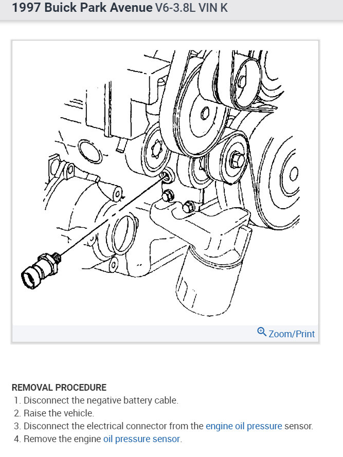

I have a 97 park ave with 117k miles last week my oil pressure light started to blink followed by a warning bell sound, so i went ahead and got an oil change, but that didn't work... now sometimes the oil light stays on and my oil pressure drop from 129psi to 0 psi than return normal and it like a repeat, have any ideas on what it could be?

Hi there,
The first thing to do is to have the oil pressure tested with a master gauge, this is a calibrated gauge that will be screwed into the oil pressure sender port. This will give a true indication as to what the oil pressure is doing if that's okay replace the oil pressure sender. Here is the location. Check out the diagrams (Below). Please let us know what happens. If it not okay the oil pump will need to be replaced
Cheers, Mark (mhpautos)

first ensure oil level is full. faulty oil sending unit o a weak / failing oil pump may cause this issue. best thing to do is test the oil pressure with a mechanical oil pressure gauge so you will be certain it is actually fluctuating. if it is, suspect faulty oil pump. if it is not then suspect faulty sending unit.

Check the oil pressure with a mechanical gauge,if normal replace the oil pressure switch. If abnormal could mean oil pump and/or engine bearing.
