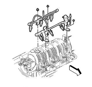

How do i replace a fuel injector on the car listed above it is a 2000 with 98,000 miles v.6 3800 series II?
Sep 22, 2007 at 4:08 AM
DENNYP
  • 1,824 POSTS

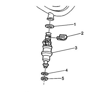

Hello, This guide will walk you through with diagrams below https://www.2carpros.com/articles/how-to-replace-a-fuel-injector
https://images.2carpros.com/forum/automotive_pictures/102900_injector_1.jpg
https://images.2carpros.com/forum/automotive_pictures/102900_injector1_1.jpg
Fuel Injector Replacement (VIN K) Removal Procedure Tools Required J 34730 Fuel Pressure Gauge Notice: Use care in removing the fuel injectors in order to prevent damage to the fuel injector electrical connector pins or the fuel injector nozzles. Do not immerse the fuel injector in any type of cleaner. The fuel injector is an electrical component and may be damaged by this cleaning method. Important: The fuel injector is serviced as a complete assembly only. If the fuel injectors are found to be leaking, the engine oil may be contaminated with fuel. Relieve the fuel pressure. Refer to Fuel Pressure Relief Procedure . Remove the fuel rail. Refer to Fuel Rail Assembly Replacement . Remove the fuel injector retaining clips (2). Remove the fuel injectors (3). Remove the fuel injector upper O-ring (1). Remove the fuel injector lower O-ring (5). Important: Fuel injector O-rings should always be replaced whenever fuel injectors are serviced. Each fuel injector is calibrated for a specific flow rate. Be sure to use the correct part number when ordering replacement fuel injectors. The fuel injector lower O-ring (5) uses a nylon collar, called the O-ring backup (4), to properly position the O-ring on the fuel injector. Be sure to reinstall the O-ring backup, or the sealing O-ring may move on the fuel injector when installing the fuel rail. If the sealing O-ring is not seated properly, a vacuum leak is possible and driveability complaints may occur. Remove the O-ring backup (4). Installation Procedure Important: When ordering new fuel injectors, be sure to order the correct injector for the application being serviced. The upper and lower fuel injector O-rings use different part numbers. To identify the correct O-ring, the upper O-ring is black and the lower O-ring is brown. Both O-rings are the same size but consist of different material. The fuel injector lower O-ring uses a nylon collar, called the O-ring backup, to properly position the O-ring on the injector. Always reinstall the O-ring backup, or the sealing O-ring may move on the injector when installing the fuel rail and result in a possible vacuum leak. Important: Fuel injector O-rings should always be replaced whenever fuel injectors are serviced. Coat all new O-rings with engine oil before installing. Install the fuel injector back up O-ring (4). Install the fuel injector lower O-ring (5). Install the fuel injector upper O-ring (1). Install the fuel injector to the fuel rail (3). Install the fuel injector retaining clips (2). Install the fuel rail. Refer to Fuel Rail Assembly Replacement . Install the fuel injector sight shield. Refer to Fuel Injector Sight Shield Replacement in Engine Mechanical.
