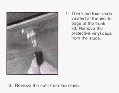

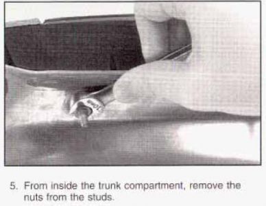

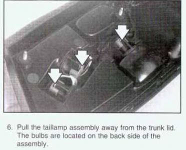

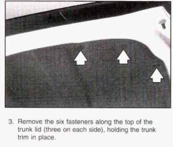

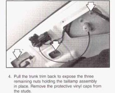

How do I repair a rear signal light on an 03- Park Ave. Tailight is sealed up with noise suppression matl

Welcome to the forum, your owners manual should have this?
https://images.2carpros.com/forum/automotive_pictures/170934_buick_park_avenue_1_1.jpg
https://images.2carpros.com/forum/automotive_pictures/170934_buick_park_avenue_2_1.jpg
https://images.2carpros.com/forum/automotive_pictures/170934_buick_park_avenue_3_1.jpg
https://images.2carpros.com/forum/automotive_pictures/170934_buick_park_avenue_4_1.jpg
https://images.2carpros.com/forum/automotive_pictures/170934_buick_park_avenue_5_1.jpg
