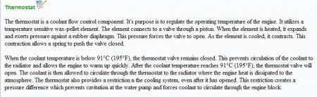

Please advise the proper coolant operating temperature. The gage indicates approx. 187 f however varies +/- 3 f.
Thanks for your assistance.

According to the specs, coolant thermostat remains closed until temp is 195 F then it opens and circulates...187 is low! Try a new thermostat to raise to 195...buy a 195 heat range tstat...
https://images.2carpros.com/forum/automotive_pictures/62217_Coolant_Temps1_1.jpg
Also use a 50-50 mix of DEX-COOL and water!
