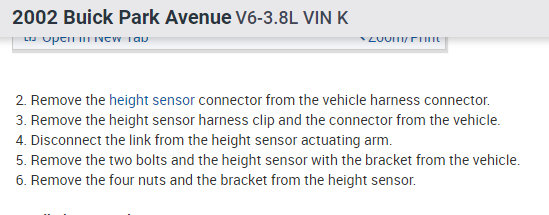

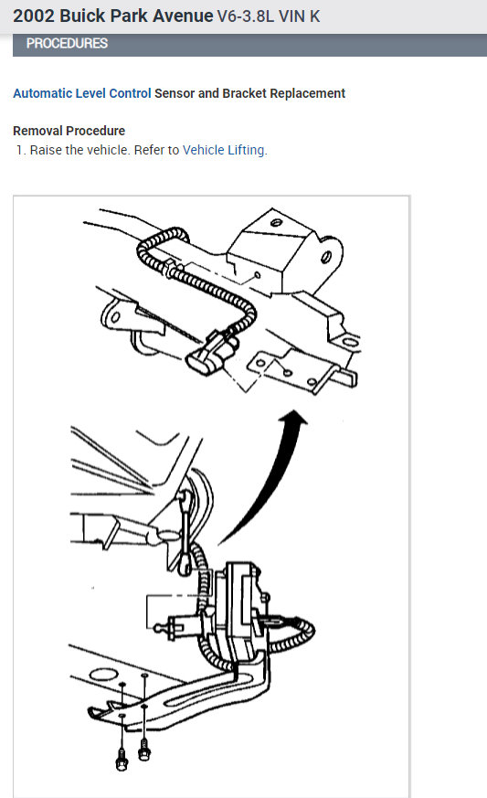

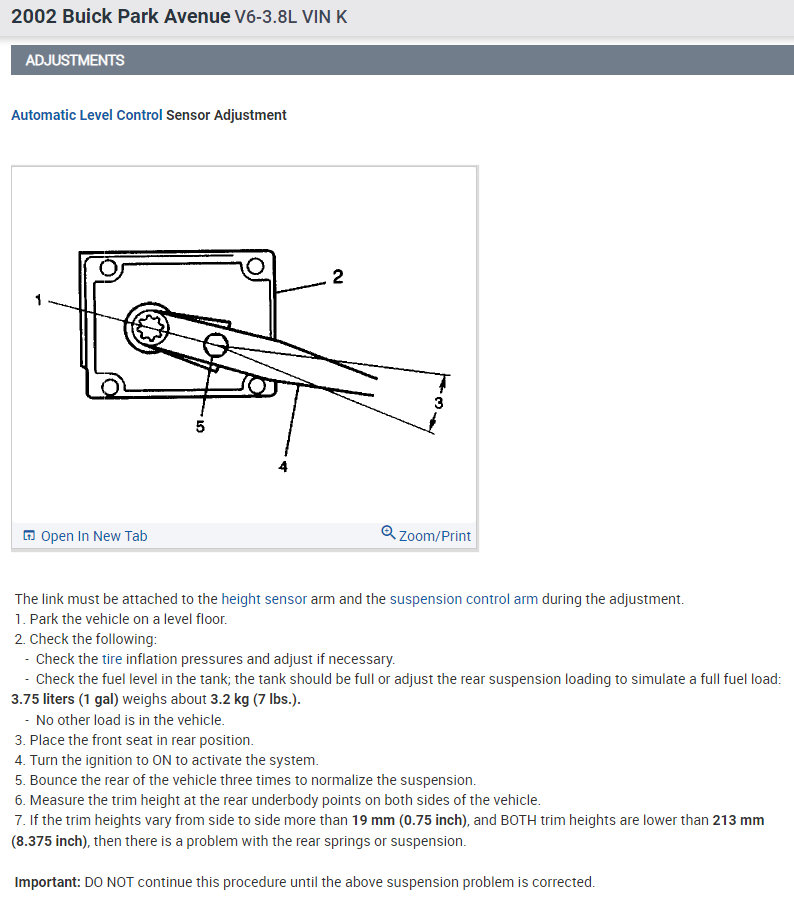

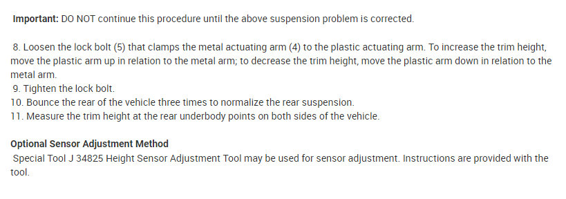

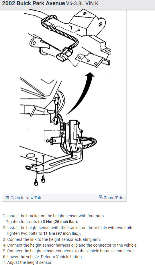

It could be an issue with the suspension ride height sensor.
Many times after replacement of the shocks that sensor needs adjusting due to ride height difference between the old and the new shocks.
It can also be due a faulty ride height sensor.
https://www.youtube.com/c/2carpros/featured
I have attached the adjustment procedure for your reference.
