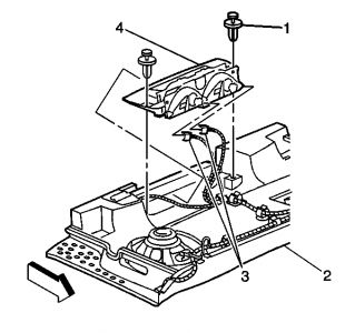

How do you remove the bulbs in the rear deck brake light panel? Thanks for the help.

High Mount Stop Lamp Replacement Removal Procedure Remove the push-in retainers (1) from the center high-mounted stop lamp (4). Perform the procedure from the inside of the rear compartment. Turn the bulbs and the sockets counterclockwise in order to remove the bulbs and the sockets from the center high-mounted stop lamp (4). Remove the bulbs from the sockets.
