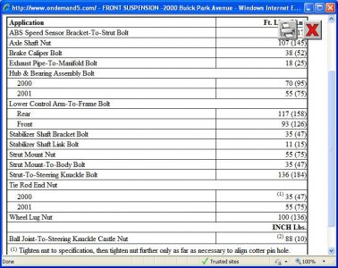

Doing a replacement wheel bearing assembly. How many pounds of torque is required? Front right wheel.

First of all thank you so much for your donation.There is all the torque spec's you need.

Your answer doesn't answer my question. How many ft. Lbs pressure does it need?For the wheel bearing. I paid $5 and got no information. Please help immediately.

I posted the torque spec's for the other thing's I thought you might need spec's for also. It's 70ft foot pound's for the hub and bearing assembley bolt's and 107ft pound's for the axle shaft nut. Brake caliper bolts are 38ft pound's and wheel lug nut's are 100ft pound's. So sorry about the confusion.

Thanks, I couldn't read the column that said 'ft. Lbs', so I didn't make it out. I have it now, thanks.
