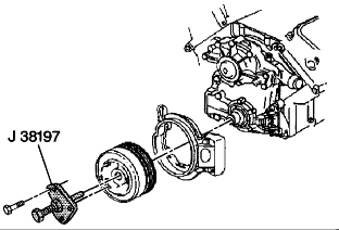

Is a special type of puller required to remove the harmonic balancer on a 2000 park ave. buick 3.8?

Removal Procedure Tools Required J38197 Crankshaft Balancer Puller J37096 Flywheel Holding Tool J36660-A Torque Angle Meter Remove the drive belt. Refer to Drive Belt Replacement. Remove the right front tire and wheel. Refer to Tire and Wheel Removal and Installation.
https://images.2carpros.com/forum/automotive_pictures/12900_c1_13.gif
Use the J37096 in order to hold the flywheel. Remove the balancer bolt. Important: Do not separate the pulley from the balancer. Service the pulley and the balancer as an assembly.
https://images.2carpros.com/forum/automotive_pictures/12900_c2_11.gif
Use the J38197 in order to remove the crankshaft balancer. Attach 1/4 in. bolts to the pulley. Screw the bolts in 1/4 in.
