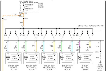

hello the sunroof does not work only the driver power seat not work radio door locks fuses good could this be main ground and if it is can you tell me where it is

If the power seats don't work, check the power seat circuit breaker, use a voltage tester, check for voltage. You may need to get at the power seat motor and check voltage there. In the diagram, the ground shows to be at the right kick panel.
