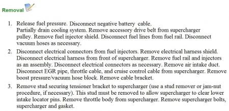

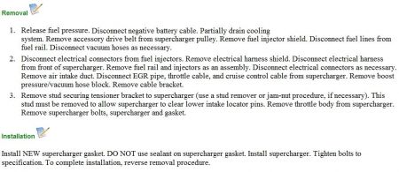

here are the complete removal and installation steps for the upper intake (supercharger). to convert inch pounds to foot pounds, you just divide the inch pounds by 12. so yes 132 inch lbs is equal to 11 foot lbs and you just simply use the foot lb. torque wrench and torque to 11 foot lbs for it.
https://images.2carpros.com/forum/automotive_pictures/261618_Noname_2693.jpg
let me know if you need further assistance with this repair.
Sep 20, 2010 at 3:19 PM
DMG0808
  • 22 POSTS
Thank you Bluelightnin6, will let you know! Is there a way to view the instructions larger or print them off...the font is quite small?
Sep 20, 2010 at 3:30 PM
BLUELIGHTNIN6
  • 16,542 POSTS
sure here you go..
https://images.2carpros.com/forum/automotive_pictures/261618_Noname_2694.jpg
https://images.2carpros.com/forum/automotive_pictures/261618_Noname2_876.jpg
