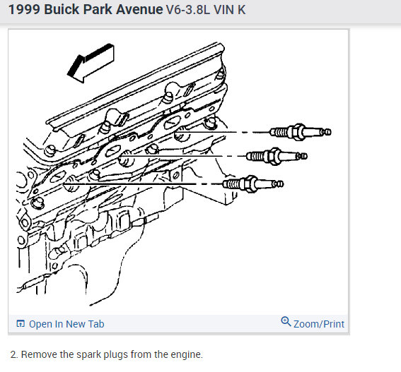

When having a computer check done we get a code p0300. The service engine soon light came on and the car started to run rough.
Please help

The P0300 code is for random misfire code. It is basically telling you that the spark plugs are not providing adequate spark to the engine.
https://www.2carpros.com/articles/check-engine-light-is-it-safe-to-drive

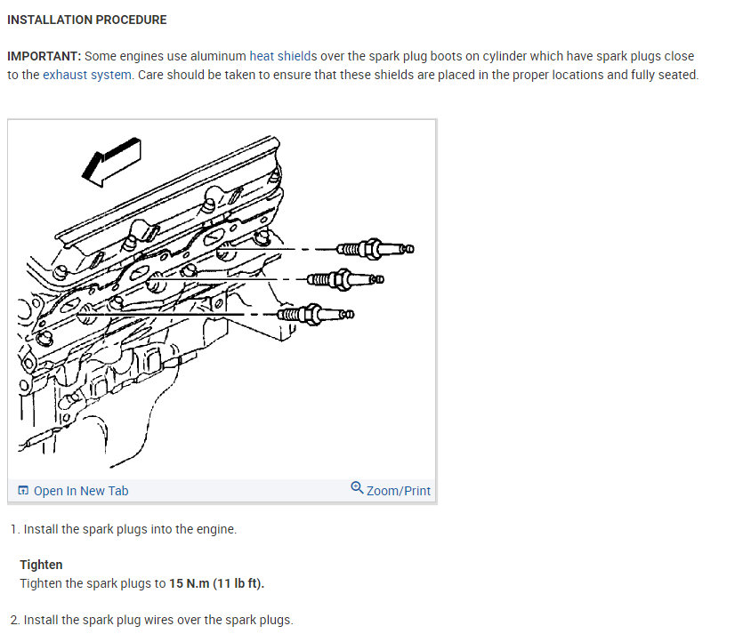

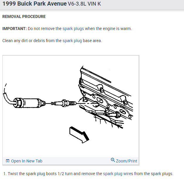

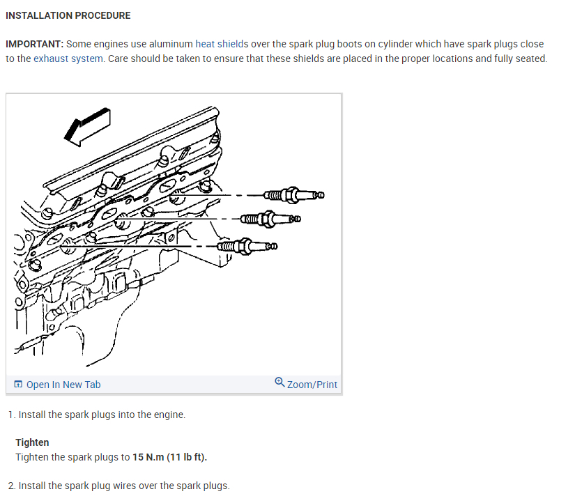

A lot of times a random misfire can cause due to having old spark plugs. Take out the plugs and do a visual inspection for excessive carbon build up. If the plugs looks to be dirty changing out the plugs can fix the issue.
Changing the spark plugs can be done using basic hand tools.
