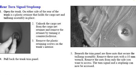

How do you change the brake lights on this vehicle?

https://images.2carpros.com/forum/automotive_pictures/170934_park_avenue_lamp_assembly_1.jpg
Welcome to the forum, this info should be in your owners manusl.
