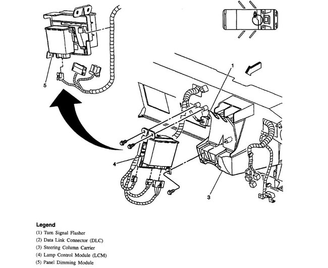

my turn signals do not work but my hazerd lights do,i changed my turn signal switch and checked my fuses so now i think its the relay.but i cannot locate the relay in any of the fuse boxes and its not visiable under the dash where should i look for this modol.
Mar 23, 2008 at 1:26 PM
  • 75,992 POSTS
The turn signal flasher is located behind the dash right of steering column carrier

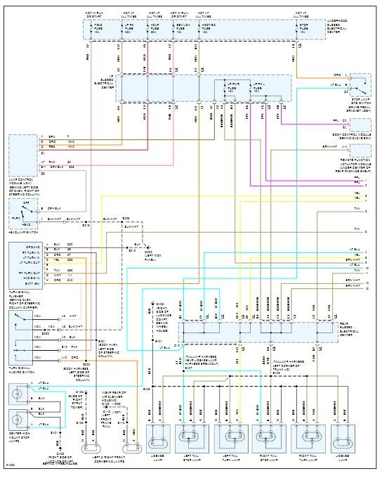

See the guide below on testing the wiring
The wiring diagrams and flasher location are attached below
Mar 23, 2008 at 1:34 PM

how do I access turn signal flasher module on 2001 Park Avenue Buick? have taken nearly all dashboard parts off, can't get to it under or over. Have new part, know what it looks like, cant see it.
Oct 23, 2018 at 6:10 PM (Merged)
DOCFIXIT
  • 18,828 POSTS
located right of steering column near hold bracket
ROY SAVASTA
David, to access the flasher, remove the stop light switch and cruise control brake switch, pull down the plastic cover that surrounds the three wire connectors directly behind the brake switch. Next, pull down the two black plastic blocks that the three wire connectors are plugged into. The flasher, believe it or not, is above these two blocks. Lots of luck
CADIEMAN
  • 3,544 POSTS
there is a clip on the right side of the column like doc said its round with yollow rings on it.

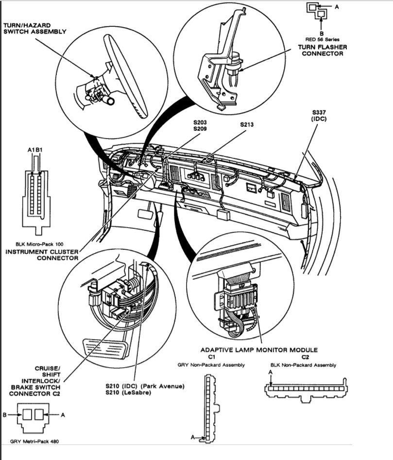

The turn signal lights on my 1991 Buick Park Avenue do not work. I believe I need to replace the turn signal flasher (relay), but I cannot locate it. Can you tell me precisely where the flasher (relay) is located? (I've seen some "hints," i.e., under the dash, driver's side, etc., but I need to know EXACTLY where it is located, please.)
  • 54,854 POSTS
The turn signal flasher is located under the dash on the drivers side here is a diagram of the location. It is tucked by the drivers kick panel.
Check out the diagram (Below)
Cheers

Where is the blinker flasher located
under left side of dash between the steering column and the center

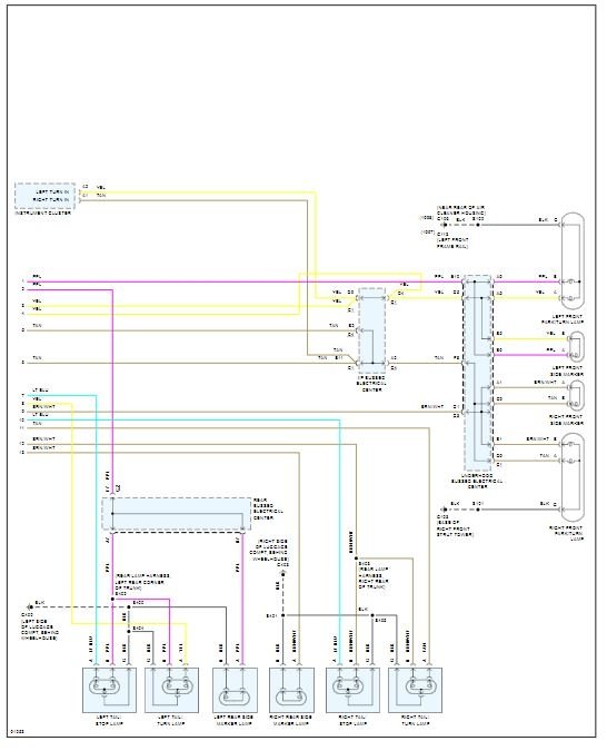

ASHLEYMCCOY
The tail lights, left signal lights, and interior lights on my 1999 buick park avenue don't work. What may be the problem?
KHLOW2008
  • 41,814 POSTS
Start by checking for blown fuses.
ASHLEYMCCOY
I've checked the fuses. There fine.
KHLOW2008
  • 41,814 POSTS
By interior lights do you mean the dash and other illuminations? Does it include the courtesy and dome lights?
For the left turn signals, do any of exterior bulbs lights up or none at all? Does turning on the hazard lights make them work?
For the fuses, apart from underhood there is one fuse block under the dash.
All these are linked to the Lamp Control Module, behind left side of dash, right of steering column.
ASHLEYMCCOY
The lights on the dash, like were the speed is don't work. My brake lights work and my right side turn signal and hazard lights work. But only the brake lights work on the left side. But the tail lights don't work period.
KHLOW2008
  • 41,814 POSTS
For the stop lights, check the bulb. Test for battery voltage to the Light Blue wire. This wire is linked to each othere between right and left.
Dash illuminations and taillights shares the same circuit and gets its power supply from the Lamp Control Module (LCM). Test the LCM Brown wire for battery voltage when taillights are turned on.
If all lights works correctly when hazard lights are turned on, the left not working could be due to a faulty turn signal switch.
