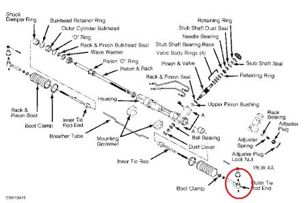

I have a 1998 Buick Park Ave. with relatively high mileage (about 138,000.) As of recent I now experience a pretty good amount of shaking in the front end of the car when going from about 1-10 MPH and then again at around 65-72 MPH. I have already checked and made sure none of the tires are loose, and considering that about sums up my knowledge of automobiles... PLEASE HELP!

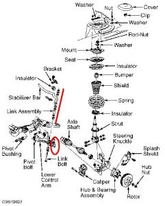

You need to check your suspension/steering parts, including but not limited to: 1. Ball joints 2. Tie rod ends 3. Sway bar bushings and links 4. Not suspension, but tires. Make sure that there is evidence of "cupping" or bulging side.
https://images.2carpros.com/forum/automotive_pictures/55316_98pavesteering_1.jpg
https://images.2carpros.com/forum/automotive_pictures/55316_98pavesuspension_1.jpg
