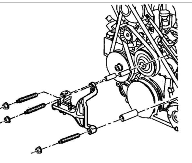

Six cylinder front wheel drive automatic.
I have to take off the whole bracket to replace the serpentine belt. I am having significant trouble taking off the motor mount! I have to disconnect the mount from the block and there is a nut on a screw behind a pulley that will not allow me to take the bracket off from the engine block.

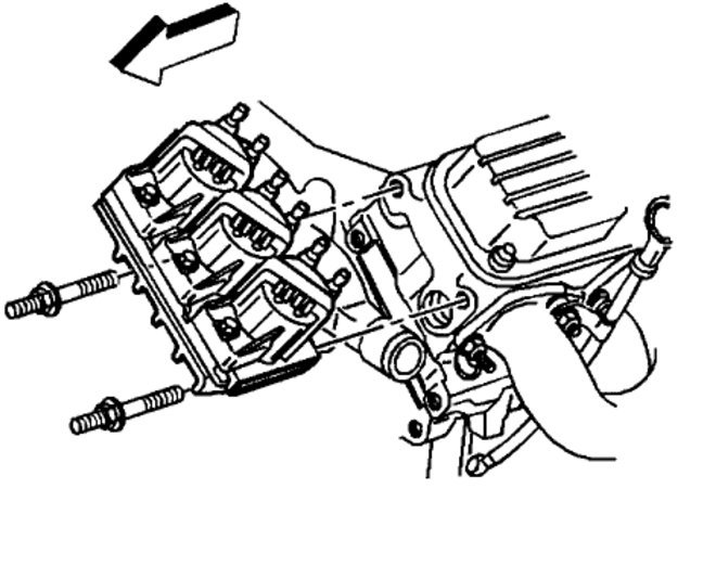

Hello, To better assist you please let me know if your model is just a Park Avenue or an Ultra. Also I need to know the fourth and eighth digit of your VIN and your engine size in liter. I have attached a picture and numbered the hardware. Which number are you having problems with?

It is a 3.8 liter V6 this diagram is only the top part of the mount. On these latter model Park Avenues (1998) you have to take mount off to take the serpentine belt off. This diagram only shows the top part of the mount which only connects the mount to the frame of the car. The mount is attached to the engine block with the serpentine belt running through the mount. My model is the type where I have to jack up motor but also the model where the belt does not come off unless i take the mount off the engine to take the belt off. The nut to take the mount completely off the engine block is somehow going behind a pulley with holes that will not align so you can actually put a socket on it.

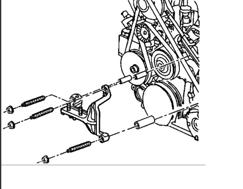

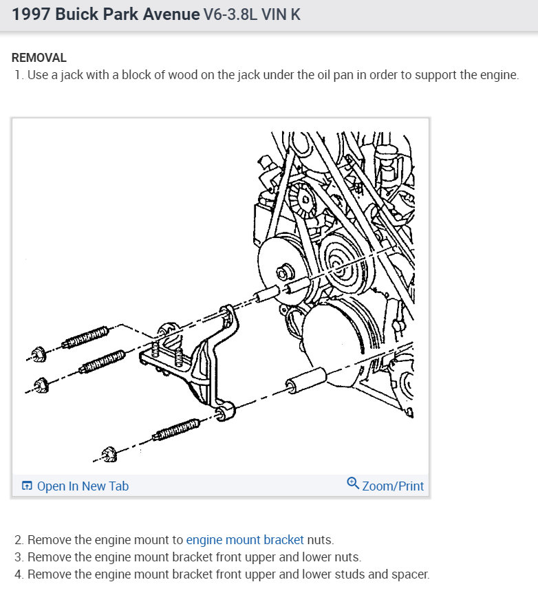

Hello, Okay, located the below picture. If I understand we need to get 5 and 6 apart or out of the way. Am I correct?
https://images.2carpros.com/forum/automotive_pictures/248015_5_4.jpg
I do not have any visuals in my information other than the picture above. Can you remove the pulley off of the power steering pump (AZ has the tool) and then get to the mount bolts and remove the mount that way? Thanks for the other post you are correct others seem to have the same problem. What was Buick thinking?

Wow! This site will be forever bookmarked. That is exactly what I need. Yes, because it is 6 that is the bolt that runs behind the pulley with the on it that I need to get off so I can fully take the mount off. I will try to go to AutoZone and get a tool to try and get the pulley off. Seems as if that is the only way to get to the nut because the holes in the pulley do not align and the nut is so far behind the pulley. I cannot even get a tool on the head of the nut, and the mount does not slide off 5 far enough so I can slide the belt through. So is that the only way to get it off. Yes I know I can probably get to it if I took the pulley off (I think the power steering pump). But I wanted to know if I could indeed take that pulley off without messing anything up, as I did not see any tool in my box that would take it off. And if that was the only and right way? Thanks man, you guys are great. My first time using the site and I am very impressed. Thank you.

If you have never used one ask them to make sure you understand because the parts that go over the pulley end are in two halves and a ring slides over. Make sure you have the rod centered in the middle of the pulley so you do not damage the pulley and mark where the pulley is to be sure when you press it back on right. Slow and steady are the two words for the day. You use the same tool to press it back on so lube the shaft a little. Also, before you remove it stand to the side or look from above to get a good view of how all the pulley wheels line up. That way when you install you can verify. If it is a fraction off you could shred the belt you probably do not want to do this twice but think how fast you would be the second time! Next, for your safety please make sure you jack/brace the engine so when you remove the mount the stress is off of it. Yes, you can remove the pulley wheel without messing t things up if you use the right tool and go easy. Well, I do not have that in the book here on how to remove but that is how you remove the many types of power steering pulleys. Glad you like the site and we can help. That is what it is here for. Lots of great moderators here on the site trying to help folks out. Also, feel free to log a feedback next to my name if you wish. Thanks again, good luck and let us know how it turns out and please tell your friends (and enemies too they have to drive too ) about the site.

I have done this job if you remove spacers 4 and 5 (by removing studs (Inverted torx ) with a little effort you can change the belt.

So, I thought it would be time consuming but doable...all good until I discovered the bolt behind! the power steering pulley! I need to vent a bit about the GM engineers on this one. I don't think they could have designed a worse routing for the "S" belt (belts on a Ultra)...The reason I needed to pull the mount was to replace the idler pulley next to the harmonic dampener on a Ultra. This item is strategically located BEHIND the motor mount! Then I noticed that the belt itself is routed so you have to pull the motor mount to replace it! The mechanics union had to be in on this one!
This thread is correct, the pulley for the power steering pump must come off to get the third bolt out of the engine block. Not an easy task due to the lack of clearance between the frame ant the PS unit even with the engine dropped. On a 1997 Ultra there are no spacers as shown in the diagram. The mount is all one piece, forged to surround, capture and cover all spinning consumables!

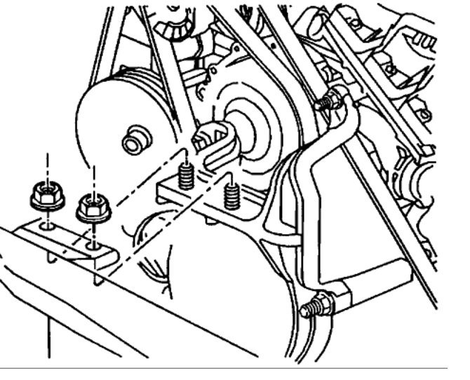

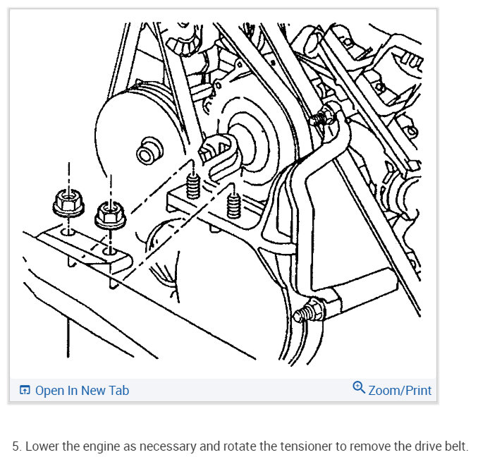

Yep soon of these designs have little to be desired. Here is what the book says about changing the belt with diagrams below.
INSTALLATION
1. Install the drive belt.
2. Install the engine mount bracket front upper and lower studs and spacers.
3. Install the engine mount bracket front upper and lower nuts. Tighten the nuts to 78 Nm (58 ft. lbs.).
4. Install the engine mount to engine mount bracket nuts. Tighten the nuts to 87 Nm (64 ft. lbs.).
5. Remove the floor jack.
Check out the diagrams (Below). Let us know what happens and please upload pictures or videos of the problem.

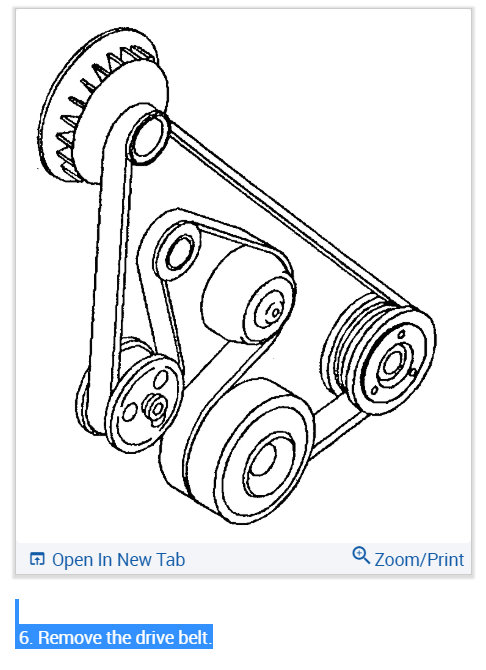

You must use a jack under the engine pan to hold it up while doing the job, also remove the negative battery cable before you begin. Here are some diagrams (below) of the job being done. Please let us know if you need anything else to get the problem fixed.
