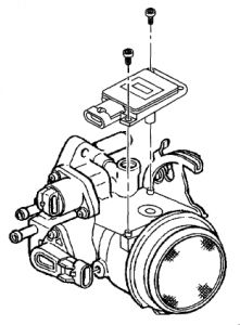

I need to Replace the Mass airflow sensor in the buick park avenue. Where is that located and how easy or hard is it to replace? Also The dealership said that there was a small leak in the fuel line. said they would have to drop the gas tank in order to install new fuel line. has anyone done this job and what dose it consist of? Any help is greatly appreciative.

The MAF is right on the intake and very easy to change.
https://images.2carpros.com/forum/automotive_pictures/561653_MAF_98_38_1.jpg
The fuel line is much harder to deal with because one end of the line is at the top of the tank, sandwiched between the body.
