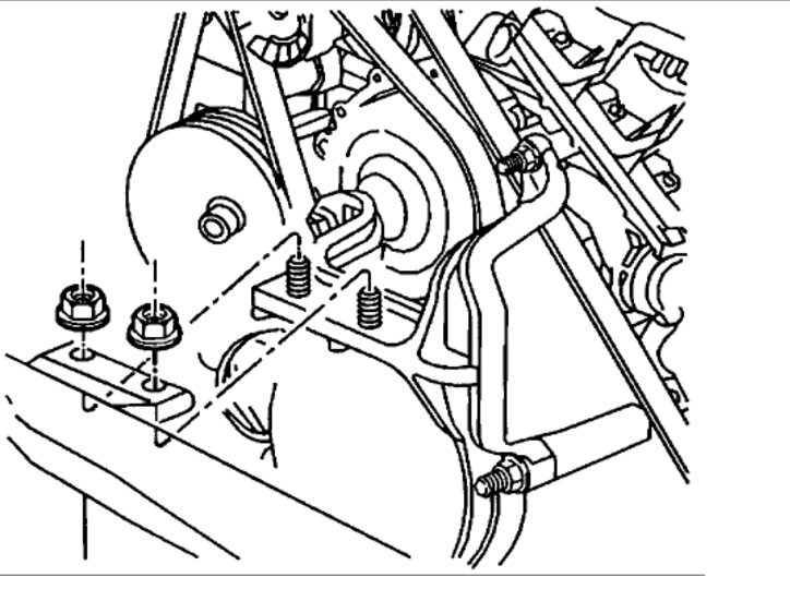

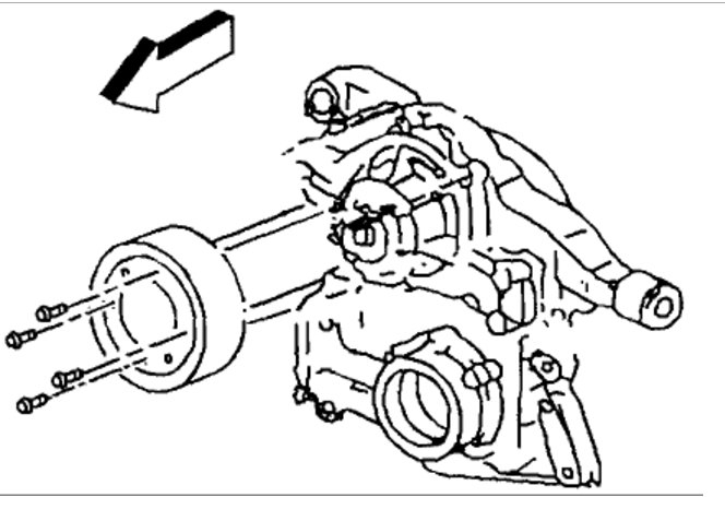

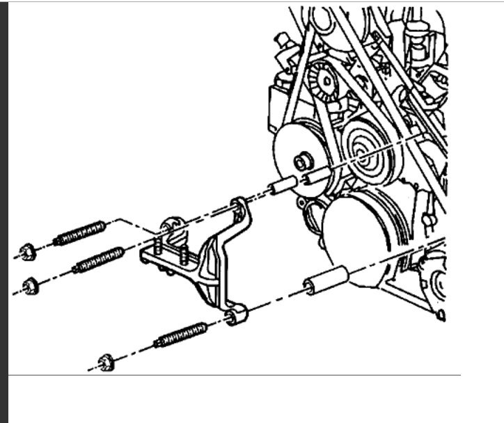

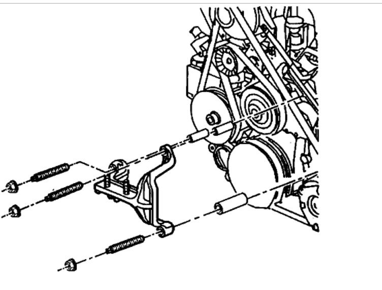

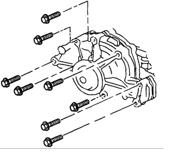

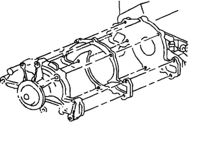

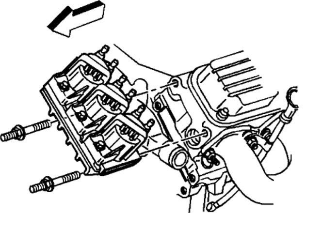

How do I loosen the motor mounts in order to change water pump in the car listed above that has an Ultra Supercharged 3.8l engine? Also, how do I loosen bolt on bottom left of water pump behind the pulley?
May 27, 2008 at 12:59 PM
  • 55,432 POSTS
Here is a guide to let you know what you are in for when doing the job and with diagrams below - click to enlarge.
https://www.2carpros.com/articles/water-pump-replacement
Here is the belt routing:
https://www.2carpros.com/diagrams/buick/park-avenue/1998
I have found diagrams for you (below) of what it is like on your car. Please let us know if you need anything else to get the problem fixed. Cheers, Ken
