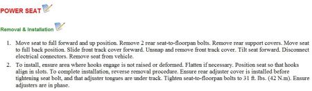

how do i remove seat/track from vehicle?
